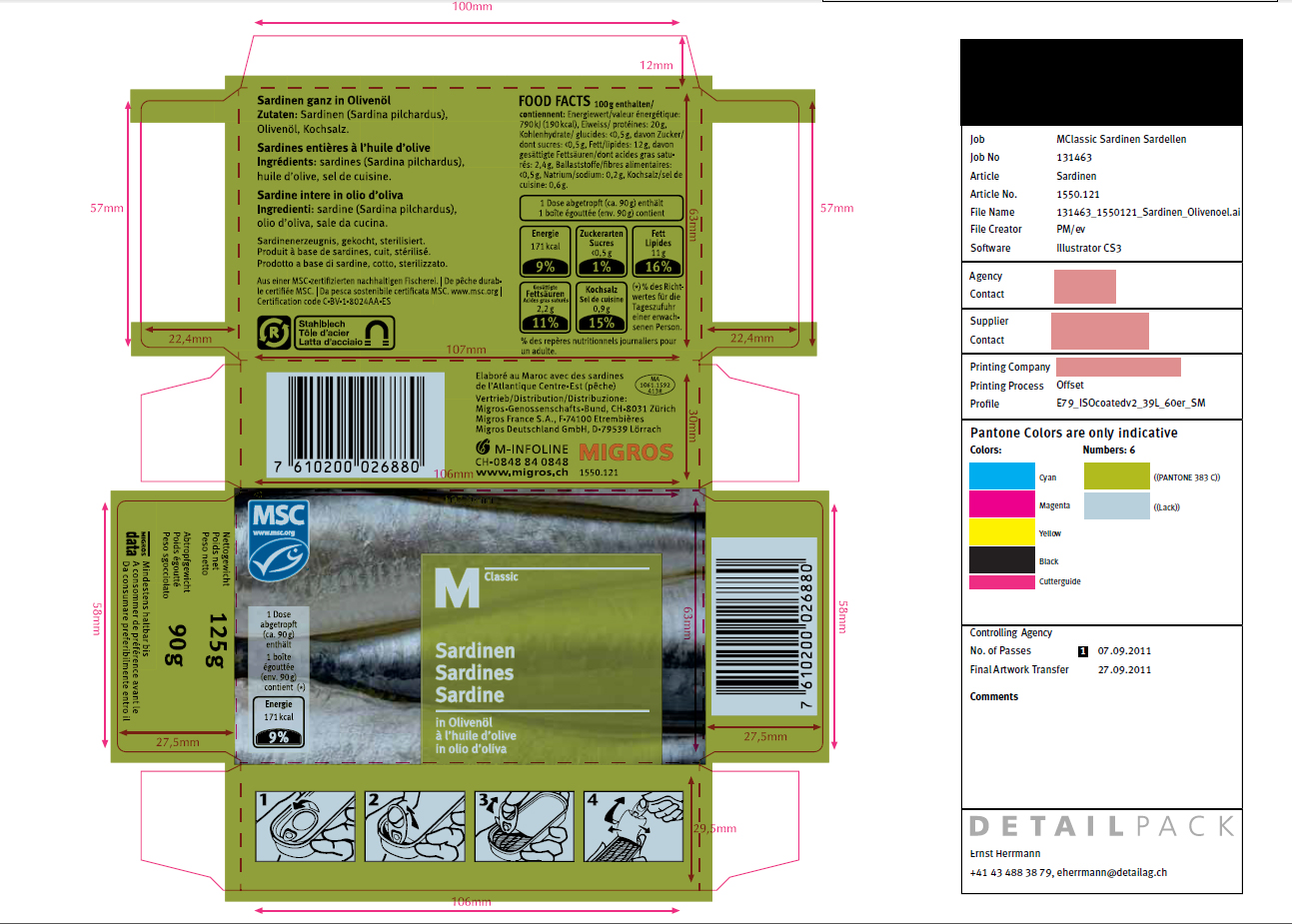

Stephen, Thanks for your reply, but I think Impact isn't what I want.
I want organize pre press files, like the artwork, not the cutter dies, I don't make dies.
We work with a company that makes that, so we don't need that much organization for dies.
In attachment there is one example that I want, that is one pdf with artwork embedded that has important information.

As is common with Packaging Files, a lot of the important information is stored in the legend in a human readable form.
I think if this information was available as Meta Data within the file your requirements would be easier to achieve and with specific applications you could go far beyond meeting your basic requirements.
A good starting point with Meta Data and Adobe Products would be to take a look at the XMP overview Adobe XMP: Adding intelligence to media
