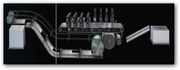

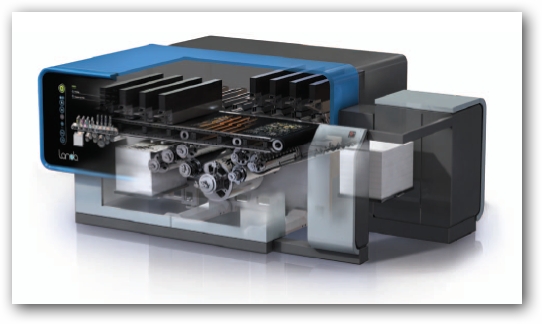

Hard to figure how existing presses could be retrofitted.(Click to enlarge). Looks like just one blanket...
I don't see how a existing press can be retrofitted. I figure the idea is that the Landa branded machines will use Komori mechanics. Landa is likely to also license the engine technology (ink ejectors, transfer belt, and blanket parameters) to other vendors to build their own platforms using their own mechanics (perfectors, etc.).
