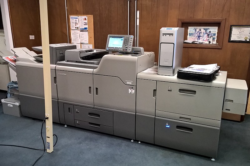

Not many people upload photos of their equipment on here but here is a shot of our first one on install day so you can see what options we got. The buffer pass unit will be installed next month as they are on backorder. That is one issue at the moment is running this machine for long periods of time the paper gets really hot and bricks up, the buffer pass is really needed for these things to cool that paper down, we are waiting to see if it will create more jams.

I'd read about that "bricking" before on here and I really cannot believe they designed a machine that can cause such an issue. Just seems like such an inexcusable flaw. I suppose if the buffer pass solves it then that's ok but then I really cant see how they could sell a machine without it. Just seems mad.

Thanks for posting a picture more people need to post pictures of their stuff.
It looks like they are going back to people that have bought it in the past and installing the buffer pass to fix this bricking issue as they are currently on backorder for several months, we could have waited for the buffer pass to get back in stock before install but elected to try it without it, it works and it is printing we are just having to let the machine idle for a bit to cool down before running more, we are also running C2S which stores the heat much more than say a txt paper would.
Hey Shawn. Are you saying that they're installing buffer passes on machines that have already been installed, for FREE? We have a Pro C901 with the same bricking issues. Our only solution is to run smaller qty's or pull out a stack of 125 sheets from the run as it's printing in order to avoid having the sheets stick together. When I brought this up to our salesman he played dumb.
I doubt they are installing them free, but they are on backorder due to large demand from either retrofits or new installs (as per our rep), the demo machines we looked at didn't have them either but are getting them as soon as they get back in stock (or so I was told), I am only commenting on the 7110.

i got the buffer on mine for free, and it solved the brick problem. You really need it.
Still, the machine have plenty of other issues.

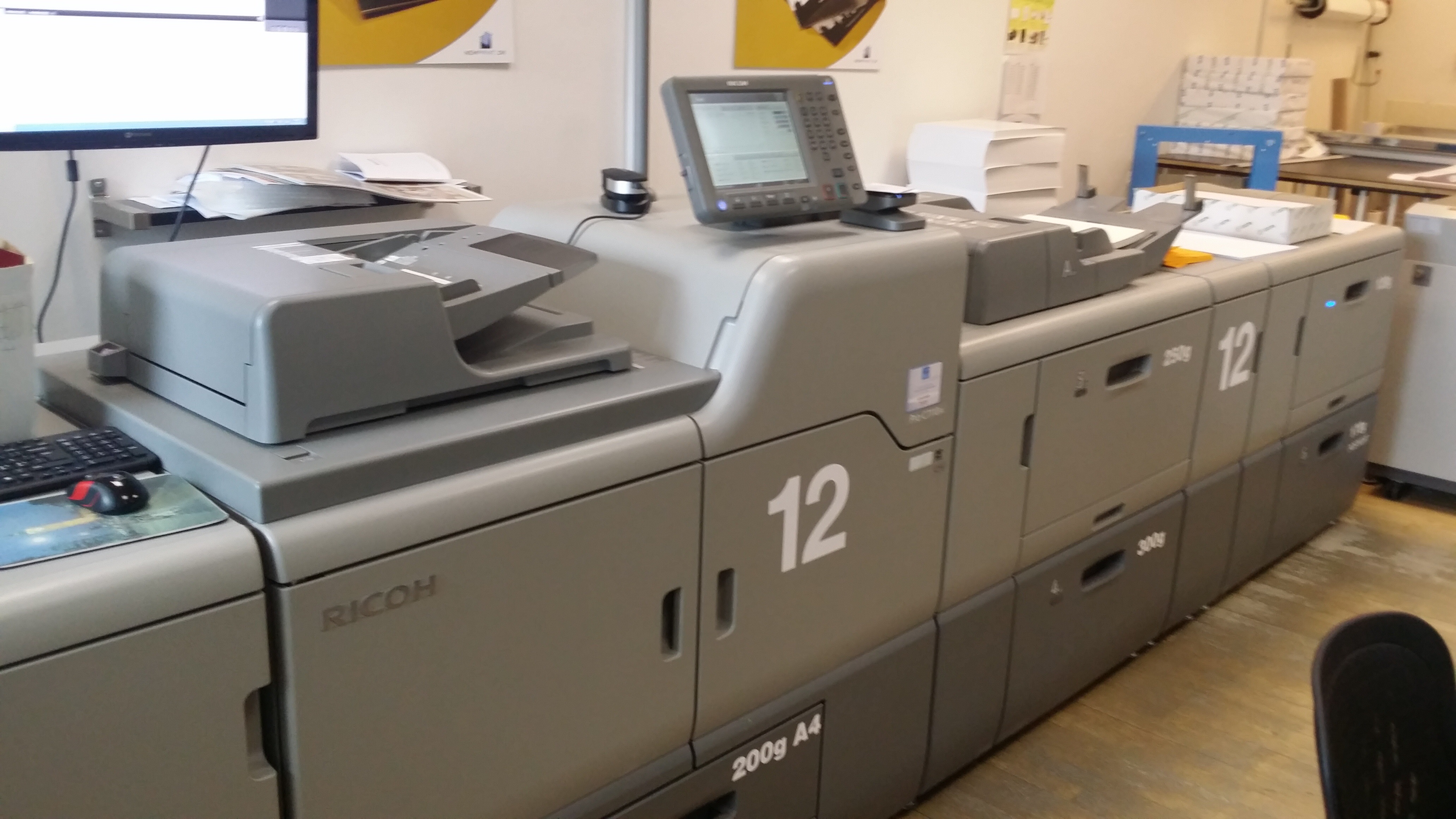

Good idea with pictures, here's one of my old setup.

Looking at your photo Shawnd you appear to have the banner unit, is this so. I ask because if I remember correctly banner length stock will not go through the buffer unit, so you have to dis-connect it when you use long stock.
Might be worth asking your tech.

I will ask about that, we don't expect to use the banner unit much as we do a majority of our work with cut sheet sizes.

Are you able to use the tray you modified for banners for normal paper as well ?
And how long banners can you make ? They set my machine up for 1.100 mm. even though its only supposed to do 700 mm.
You don't need to disconnect the buffer units for the banner printing and you can use the banner tray for normal stock too, only problem is loading the paper is like trying to birth a cow!!
