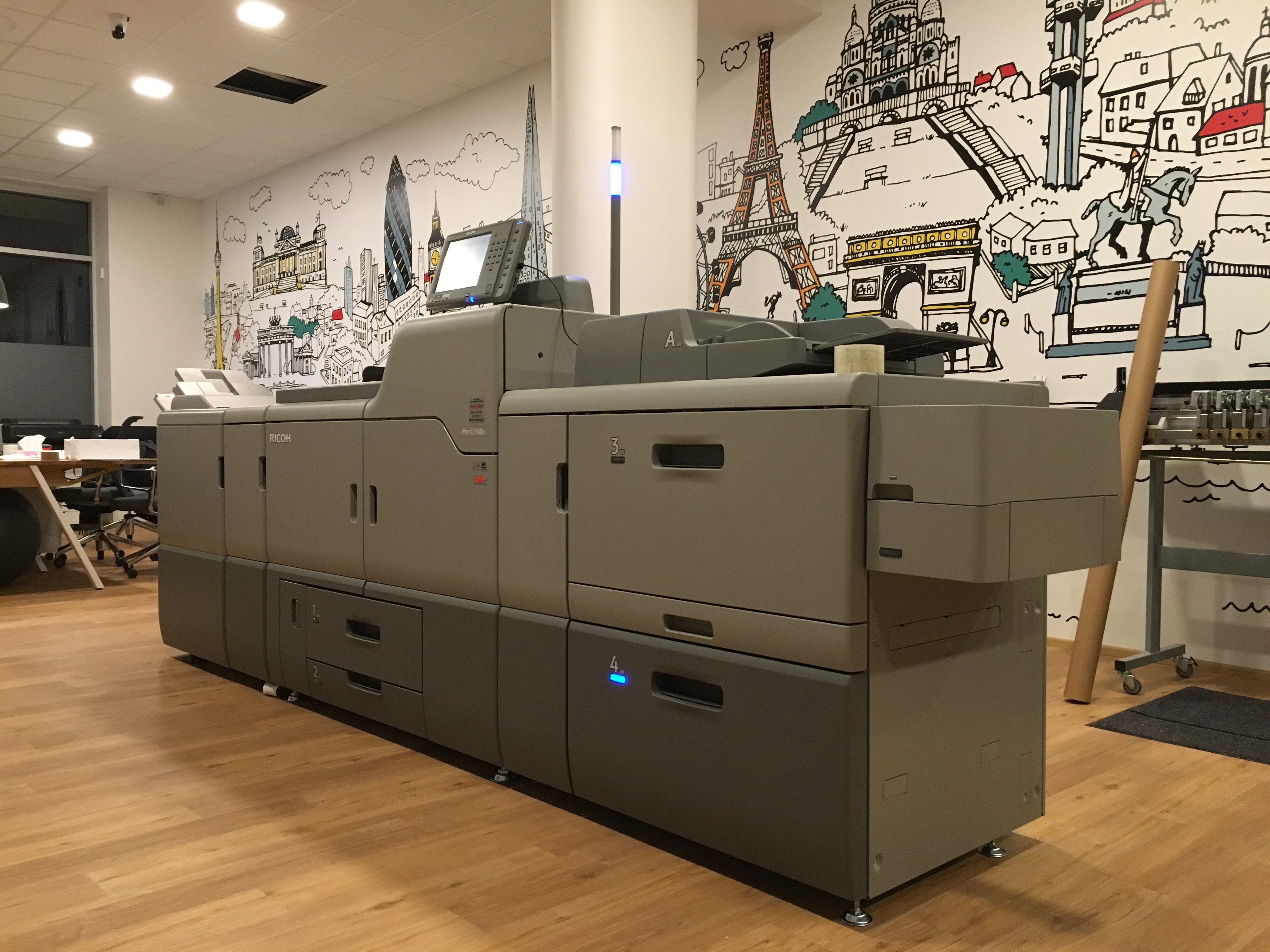

New Install - Ricoh Pro C7110SX
To run envelopes you need to disable skew detect, double feed detect, and enable "deactivate image position adjustment" if you have done that and are still having envelopes jam post the jam code (look for JXXX at the top of the jam screen) I am sure the local tech will be able to help too.

I've had the machine for several month now and it's pretty good once you get the hang of it... It's mainly paper settings and how you setup the job that you need to get ready for. For example never run textured paper in banner format as the ink will not adhere properly. Try going to a smaller sheet and you will get better results on textured paper... The main strength of this machine is registration I think. We've been surprised by how well this machine gets registration accurately... Although when the sheet is banner format registration becomes tricky to achieve.
Yea, the registration has been spot on so far, the guys on the cutter are amazed how every time the blade goes down it is right on the marks. Night and day difference from the Xerox 700, just sayin.
we have the printer just for 2 weeks, so fare / perfect registration - no need some extra setup - just put the paper to library and it works :) front to back perfect tight, huge different to old X700. Yesterday we had done job 300 x 500 mm, sizes that we would normally have to sent to offset print. Well it was done in just 10 minutes :))) Our tech was playing with some gold foil lamination today, looks promising - basically its like you print black than run it through lamination with foil (gold, silver, etc.) and the black toner transfer it to paper. Its really nice application. So fare vary lucky and i love it :))
