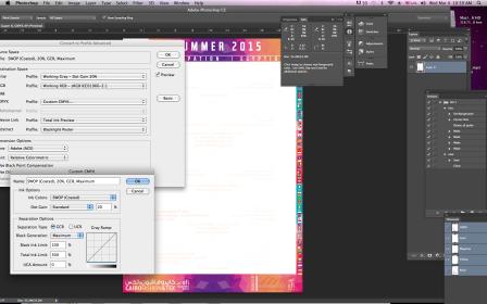

i try to convert black color in any file to black channel in this method:
From photoshop
Edit menue - convert to profile - custom cmyk - maximum - black ink 100 - total ink 300
this method worked perfectly in photoshop
and i see black color in black channel only
the problem is:

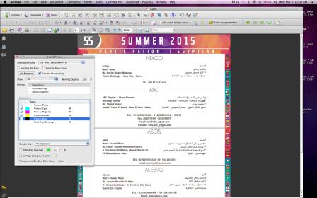

when i convert psd file to pdf
from adobe advanced menue - print production - output preview
black color appear in four channel
i need to know how to solove this problem

THANK YOU for reply
I take screenshot for file in photoshop and the same file in acrobat pro :confused::confused::confused:
I hope it will help

I used - custom cmyk in photoshop to put black color in black channel only
this way i knew from printplanet site and i find it easy way
i need to know how to remove black from other channel both in photoshop and acrobate pro
because files sent to print in pdf format
