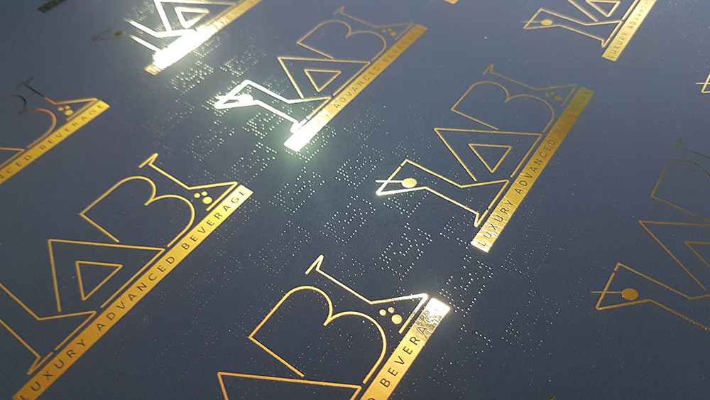

For reference, here is a photo of the problem I am getting.
Thats called a steganography pattern. Its a yellow dot pattern to quickly identify which printer/serial the print came out of in case somebody wants to counterfeit. You have to print in grayscale (like the other gentlemen mentioned) in order to avoid this. You get this for spot gloss (because you have to print in color) but its less noticeable because the yellow microdots dont offer much toner coverage.
