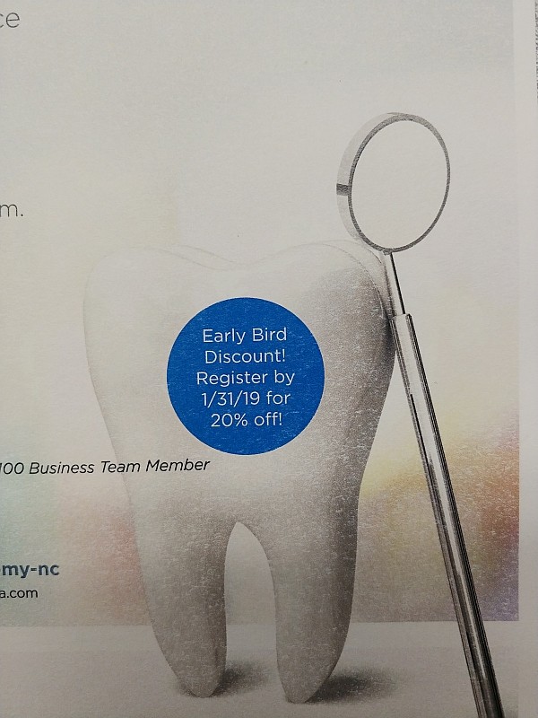

This is what I am encountering on 70# text that the tech will get to go away for a week or two then it will come back:

We only move a job when we encounter this, but it will print fine on the other 7110 on 70# text, I have checked all the advanced settings for the paper are the same on the two machines, but one will print it fine, got both me and the tech baffled.
Here is another twist, I ended up finishing the job on 80# Gloss text, it looked alot better and the solids while not perfect was passable on the same printer that gave me issues with 70# text.
Creating a new paper profile did not work for this job.
fetch

That looks pretty gross, but I have noticed in not smooth stock like this, that the paper itself can vary...or even one side or the other will be smoother. Example, we recently had a long run of books that were entirely color, but printed on just plain 60# stock...you could see some pages look better than others. I think a lot of that is the nature of the stock...maybe you can try a smoother sheet?
In the Xerox world I can adjust transfer settings to usually improve this, I am assuming you can do something like that in Ricoh? As the seasons change I noticed the transfer settings will not always work the same way either...if the climate varies in your shop that could be part of the problem as well.
