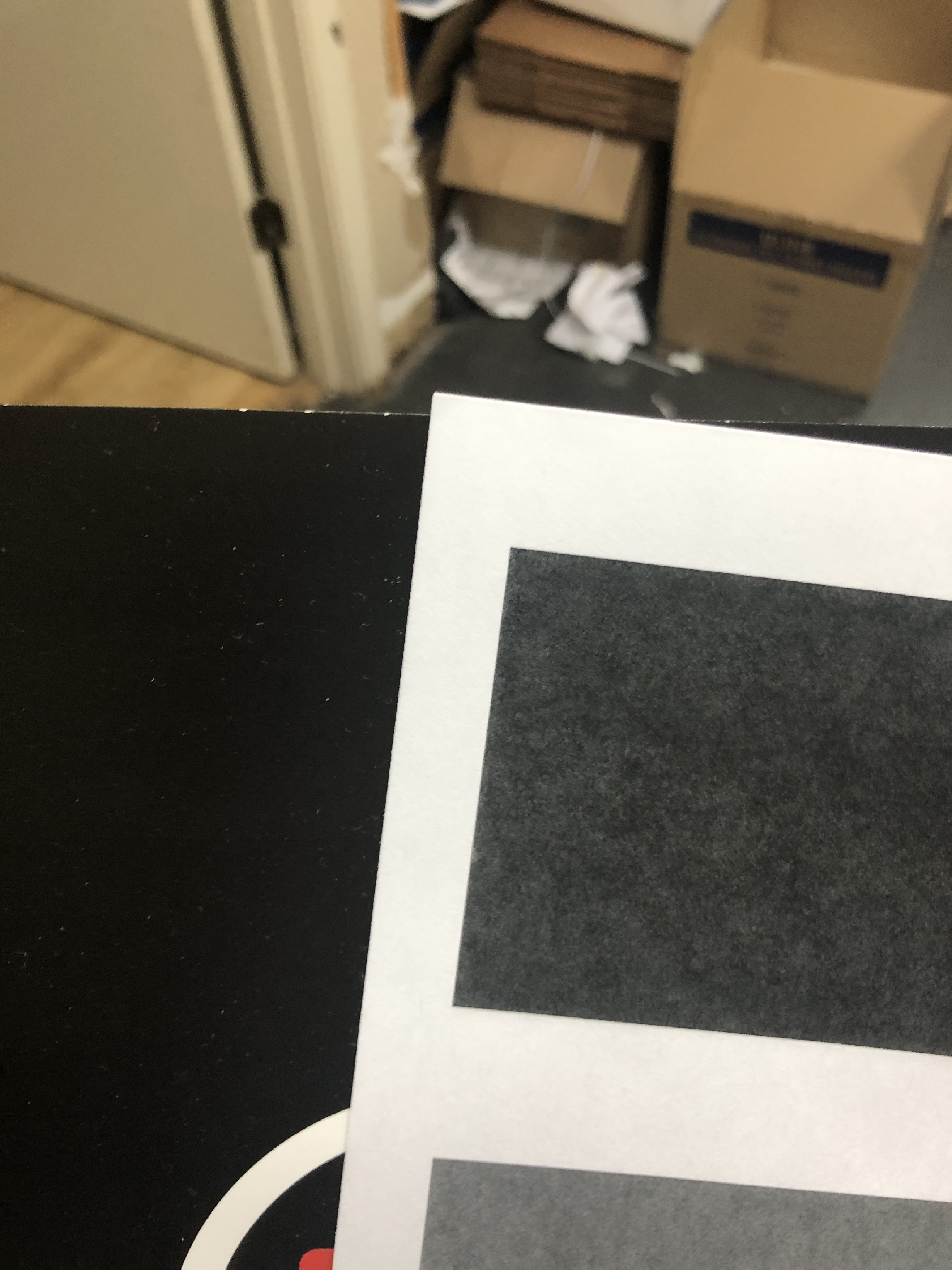

I want to see if anyone can help out with this fading black that has all of a sudden come into out c7100. I just fired up this morning and ran a load of black only prints to find they looked awful and faded. Went back to the test sheets and this is what's coming out.
Also, I tried to execute the DEMS and initial settings, but both processes failed. I do not know of a reason why either of these processes would fail, so any insight on this too would be helpful.
I have increased the image density to no change. I've switched to grayscale only to no change. I've played with the currents some, but feel like it must be something else. Nothing in my environment has changed either.
Any help would be greatly appreciated! I have attached a picture of the today print next to a true black run before.
