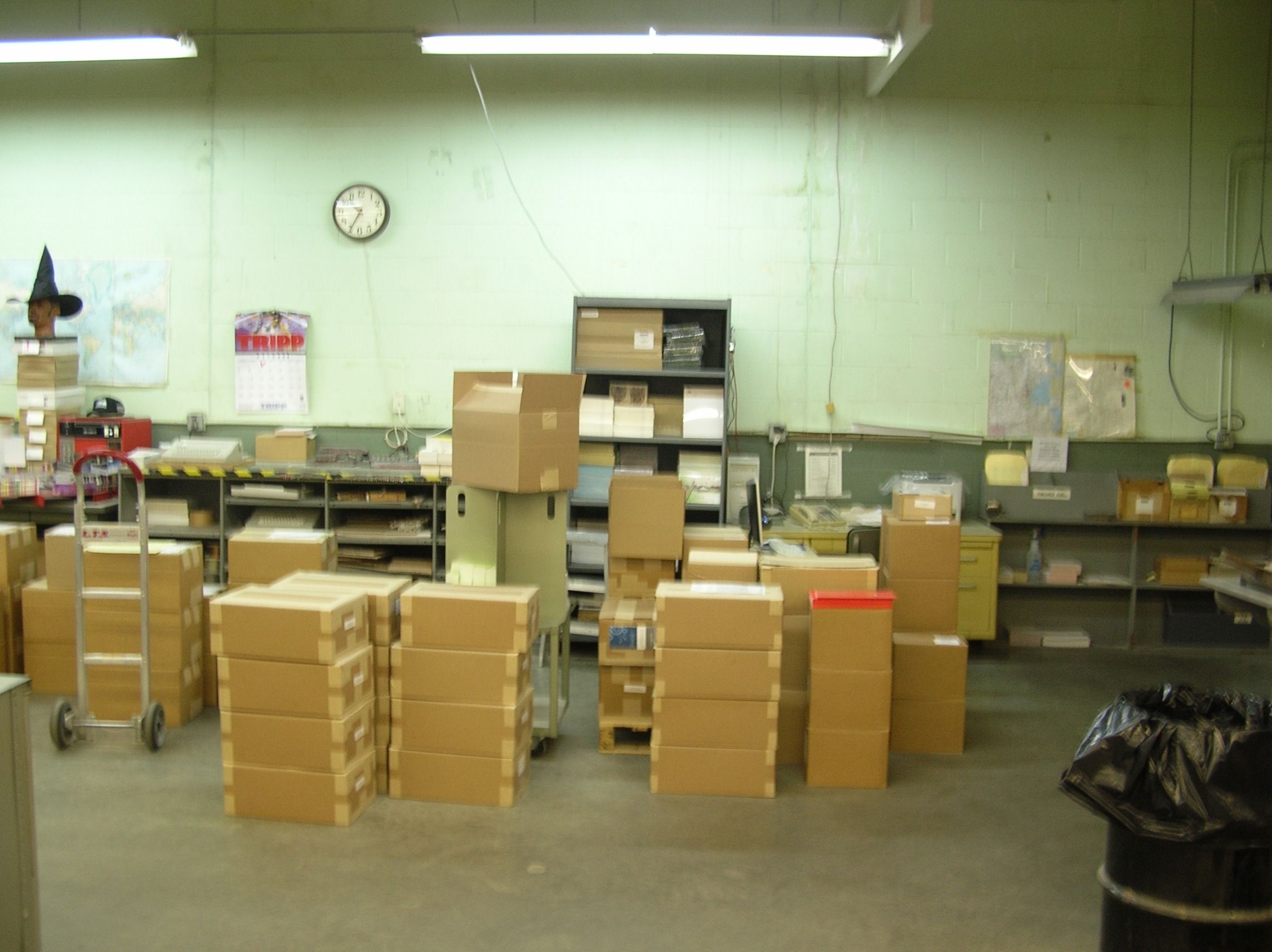

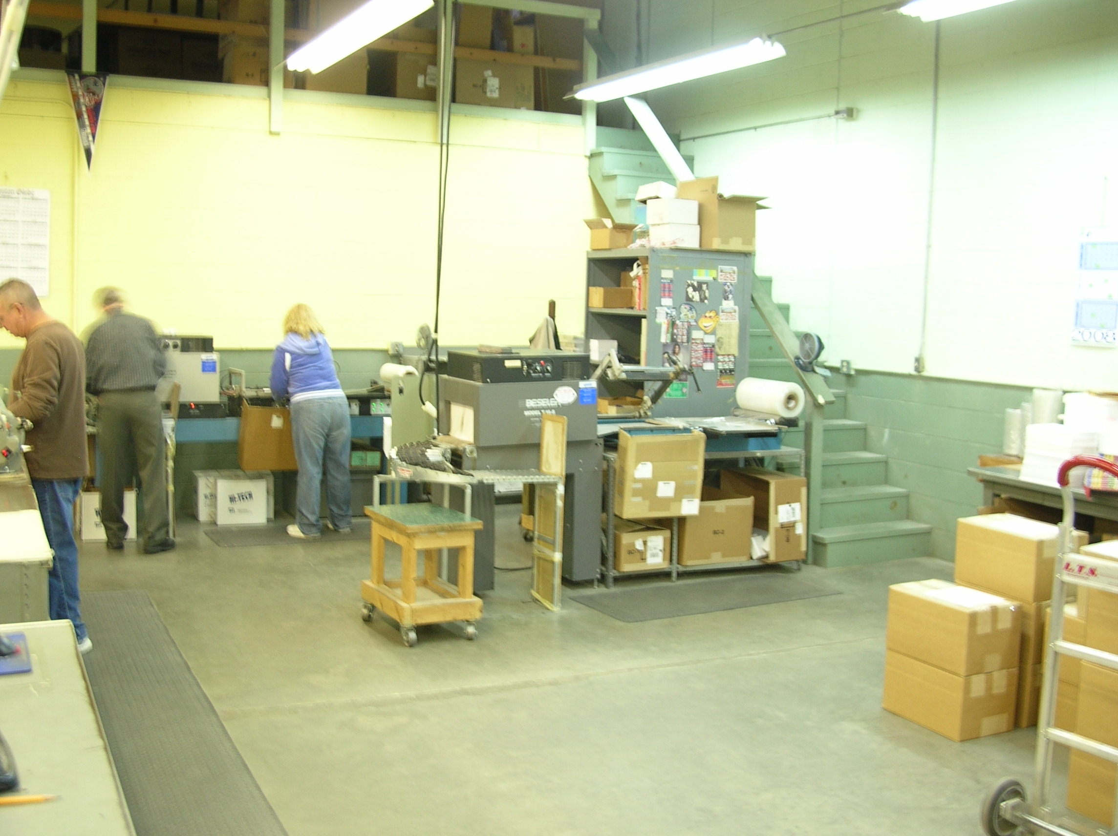

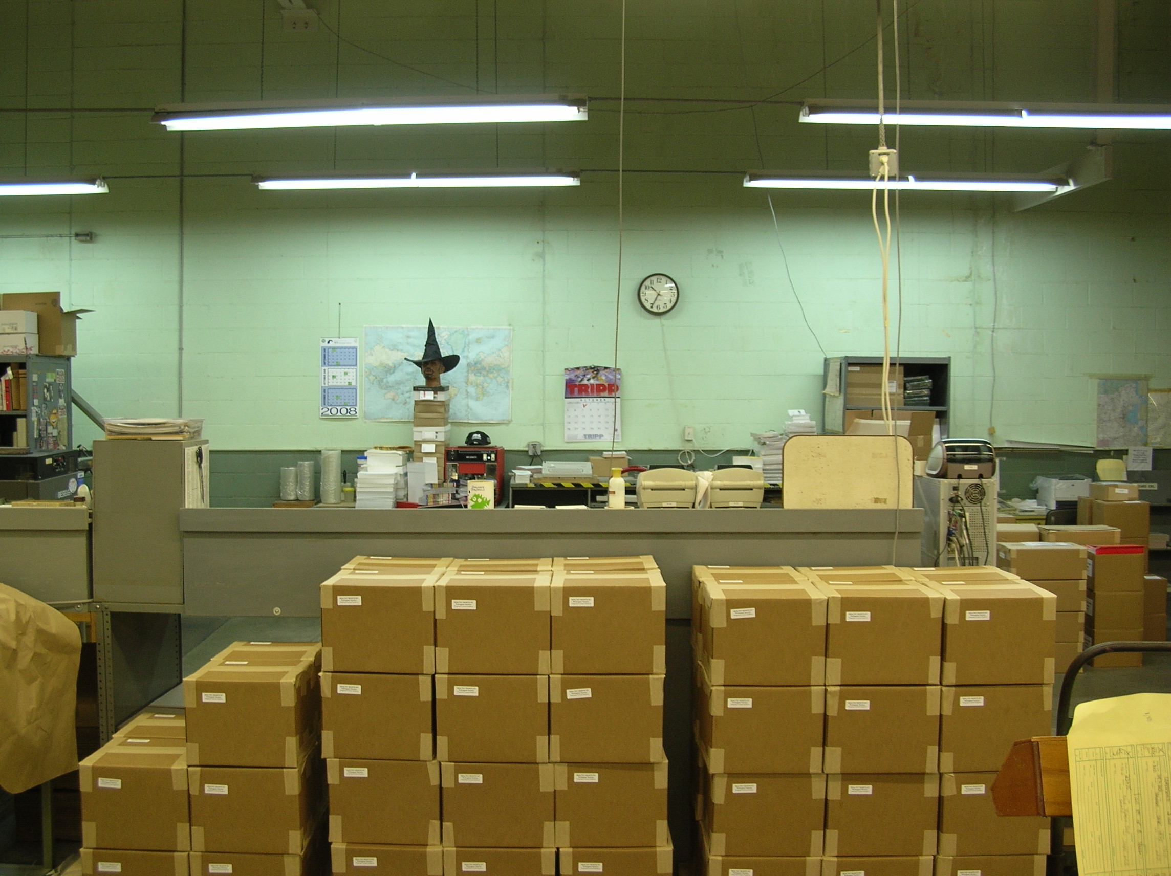

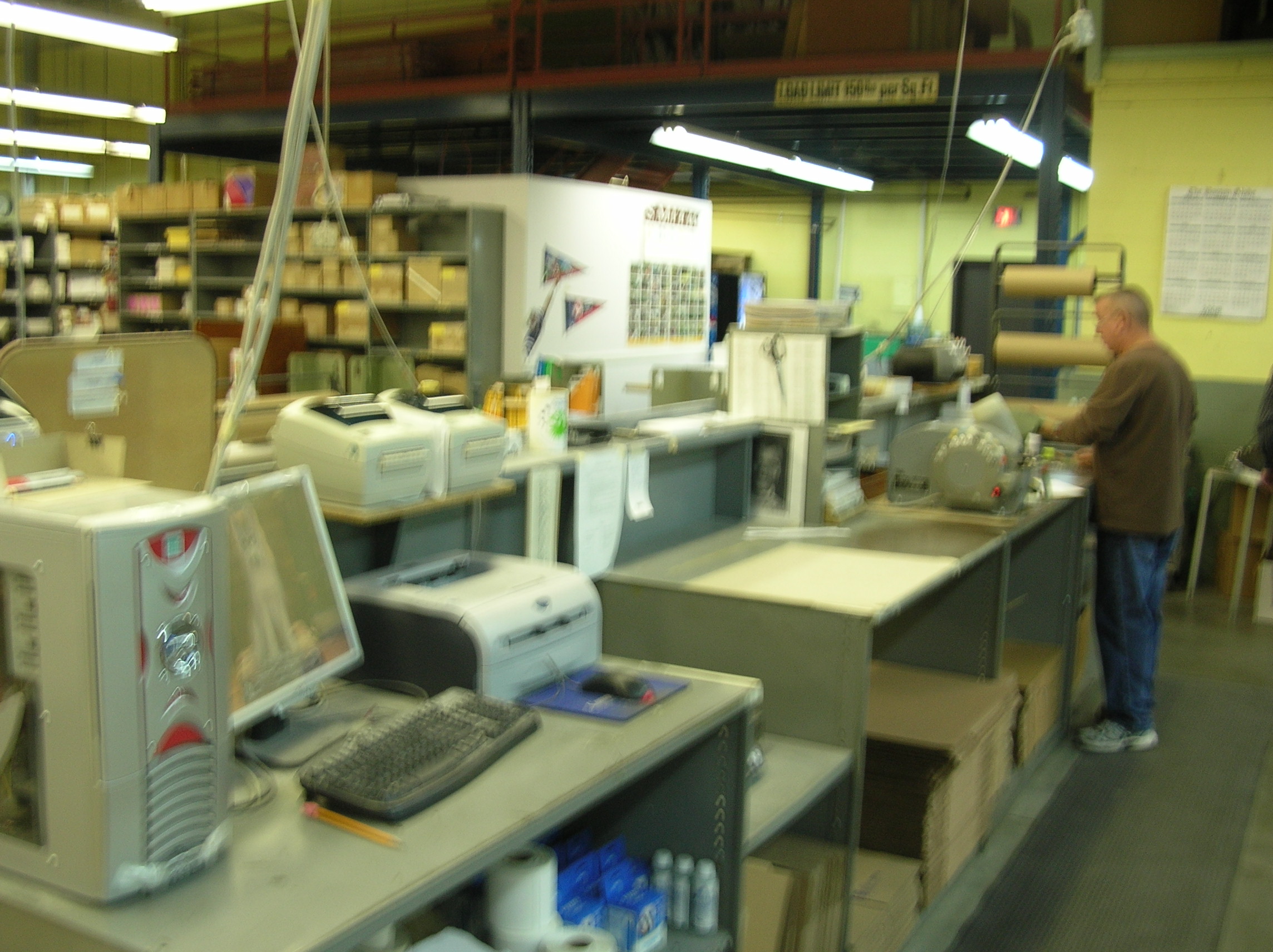

The items I do have progress with is the shipping area. Again, I have been planning with the "facilitator" about how to organize the area with our shipper and we came up with a few ideas. I have attached a PDF version of what the area will become + what it is currently. As you can see, there is just tons of stuff everywhere. Nothing has its place and no one would be able to pick up the shippers job if he was out sick. I am hoping with the setup drawn out on the PDF that there will be a lot more room and that jobs will be better organized coming and going through the shipping department.

Edit: I apologize for some of the pictures being blurry, my camera is old!
