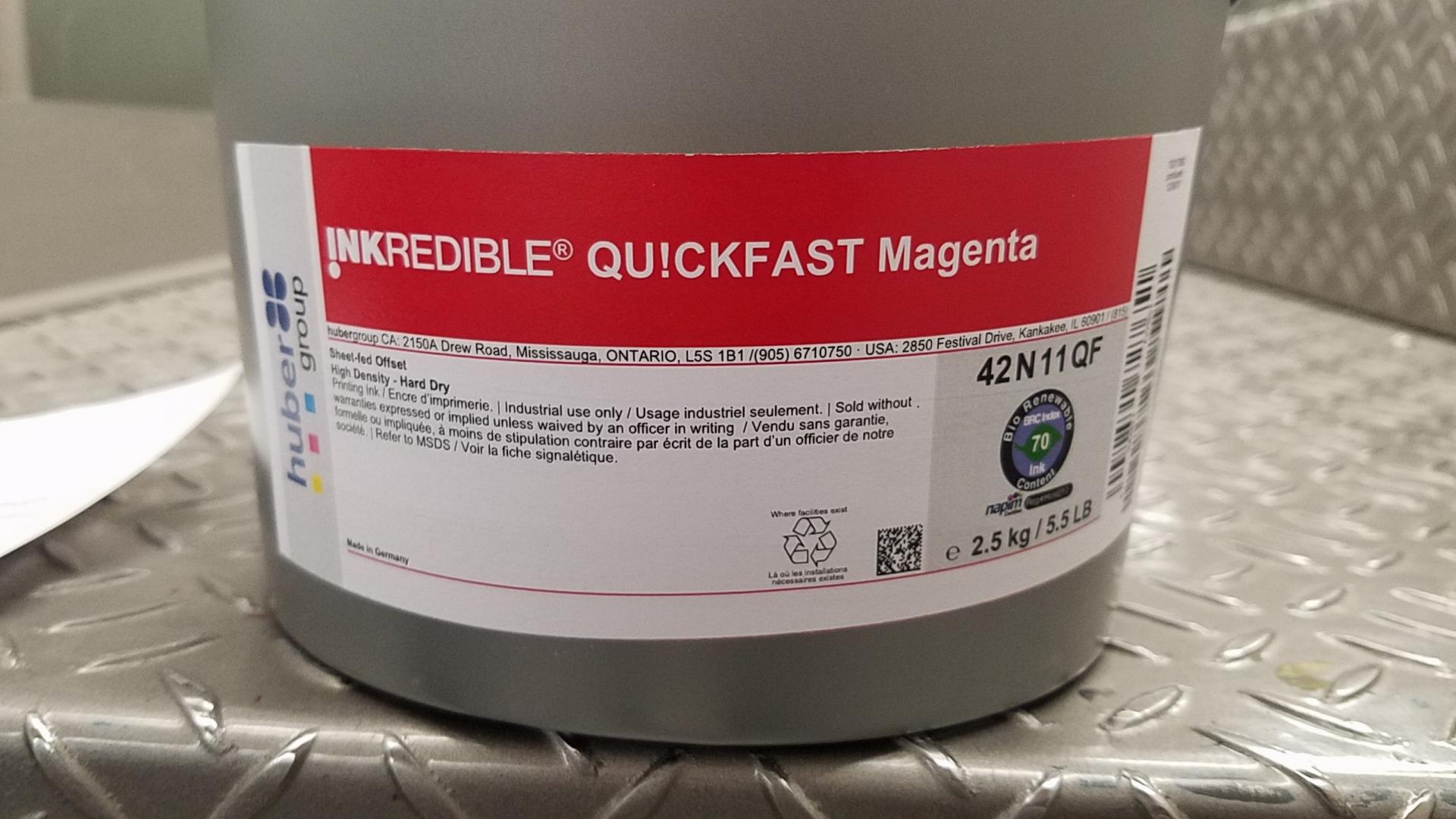

Ink is: Hostmann/Huber CMYK. Image attached.
Fountain Solution is a two part solution: Flint Group Supreme 8168 (2part/gal) and Fuji ARS ML (1 part/gal)
Job is CMYK. Medium coverage with a couple of 2" blue bars. The sticking is happening mostly where this heavy coverage is. Normal powder was used on the job. In hindsight, I would have used much more powder.

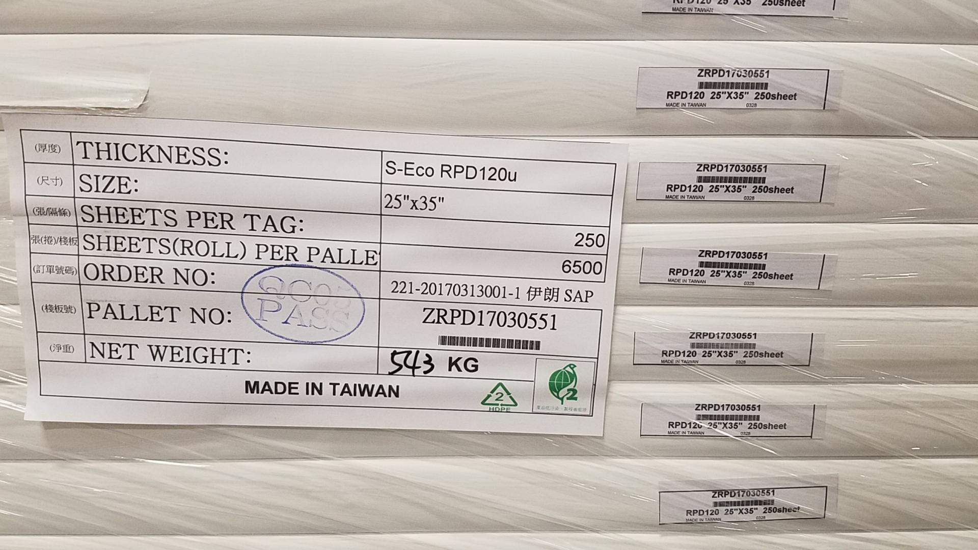

Do try and be "Sensible" with your description of the "Substrate" !!!! ..... no such paper exists that you describe, NOW show us a Label from a ream or pallet of paper.
