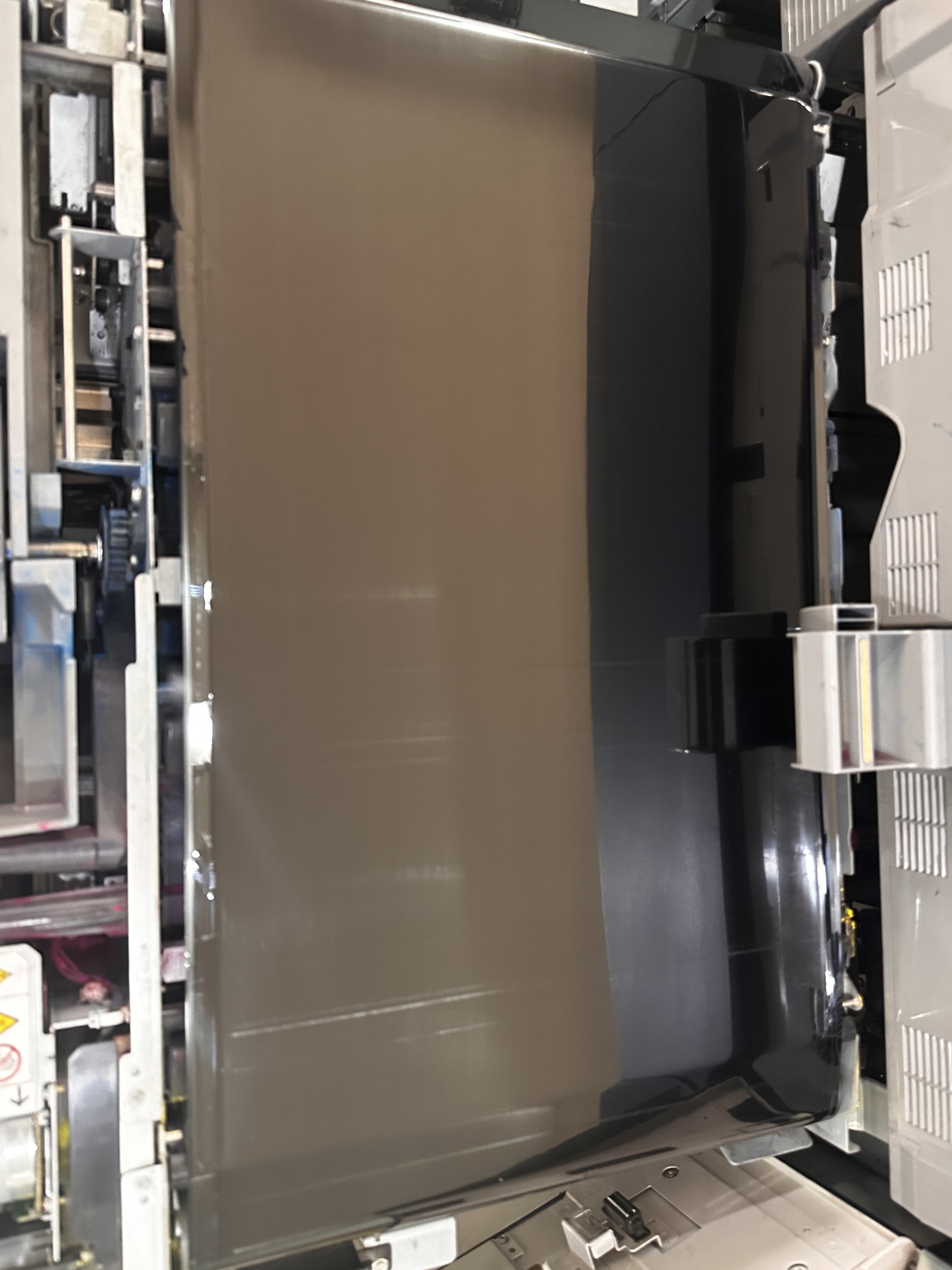

I chek All I found The scratch on film i tray to clean. i witll change
Thank you guys
Thank you guys
you are cleaning that yourself? I would never touch that on our Versant 2100 and never had the type of issue you showed in your pictures. Might be you are causing this yourself by cleaning this.
Black drum may be getting low on life. On the V2100's the black drum is always active (which is why you're seeing the issue across all colors). If you switch the black drum with the magenta drum and the line changes color you'll know for sure.
You can extend it's life by switching black and yellow drums as the defect will be less noticeable with in the yellow drum spot. As a general rule the drums rarely last as long as they're supposed to.
