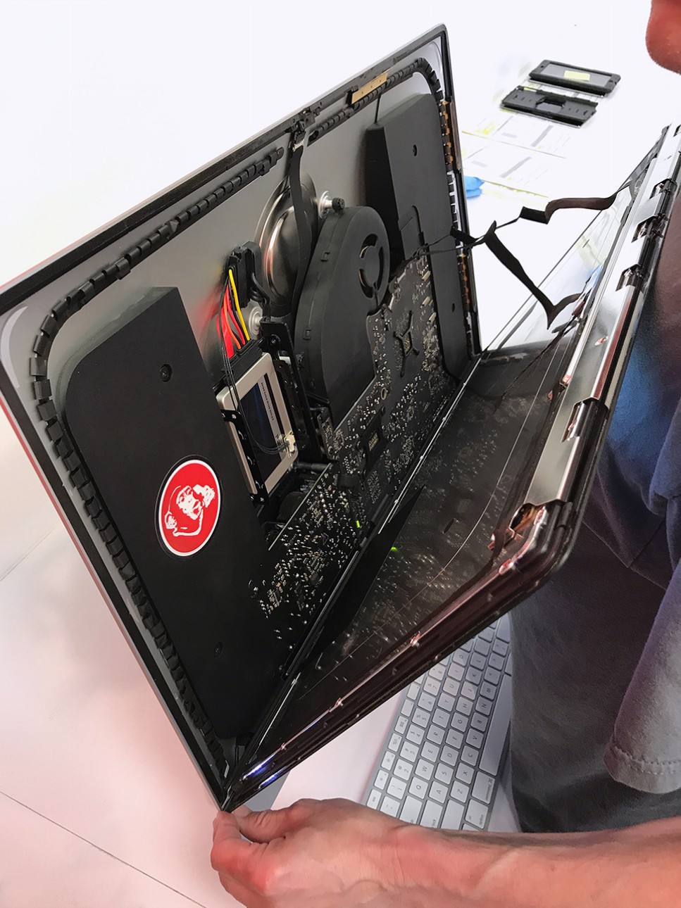

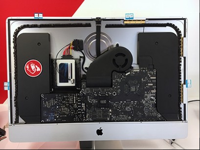

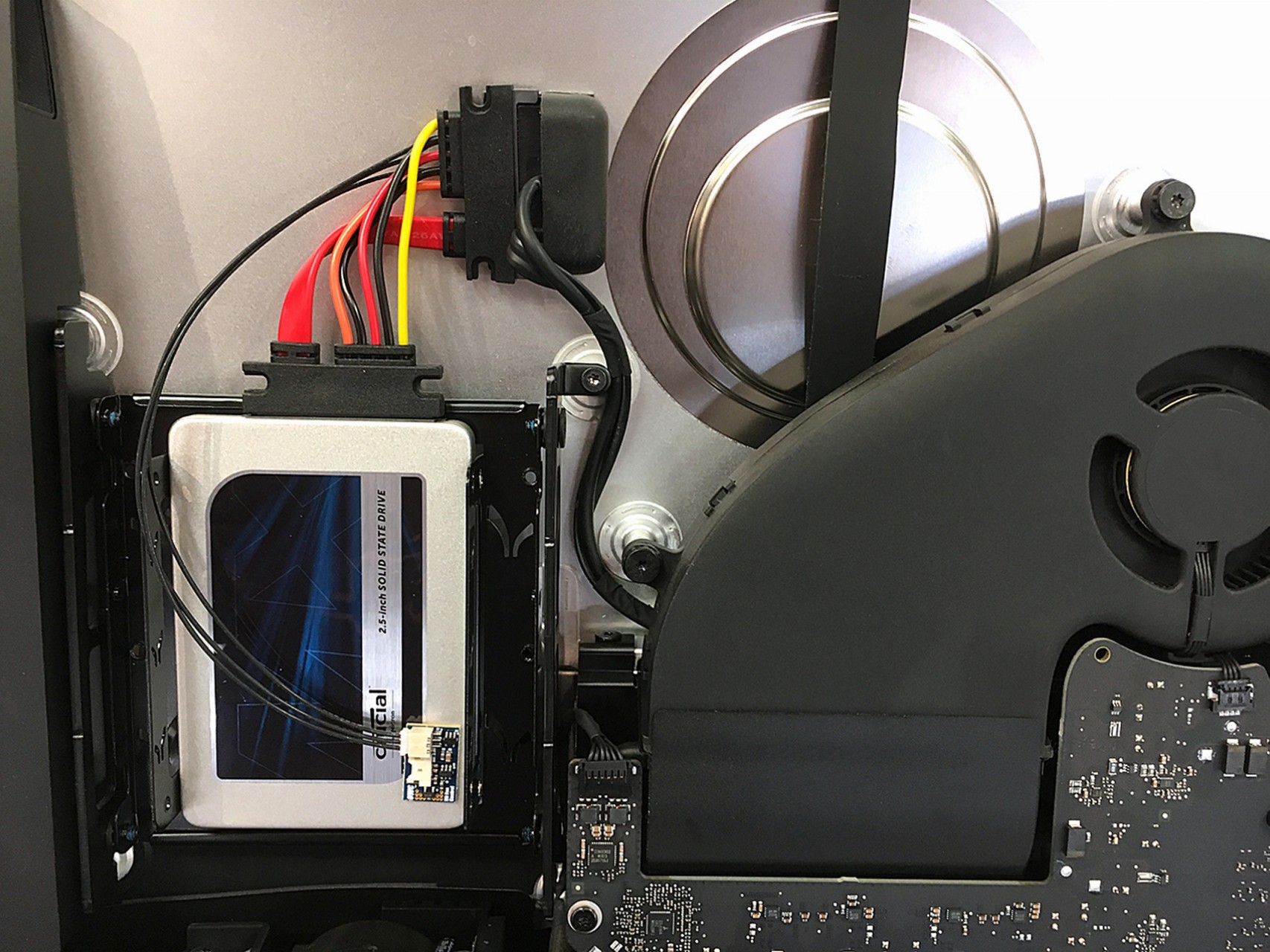

We have several 2012 27" iMacs. We are on the Creative Cloud. We had MAJOR lagging issues. That all went away when I replaced our platter HDDs with SSDs. It is not an easy process as the iMacs are sealed, but absolutely worth it!

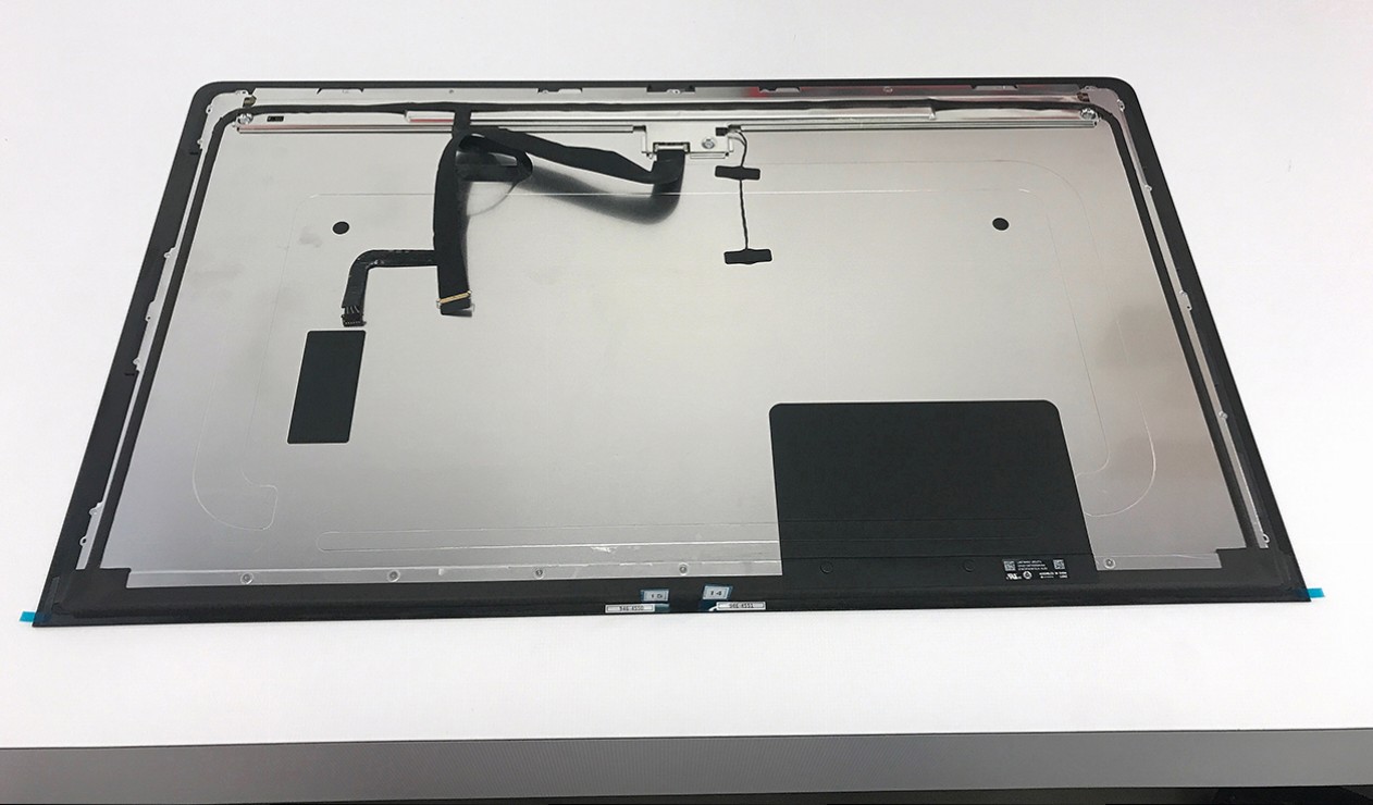

Here is another one of our late-2012 27" iMacs that I upgraded last weekend.
It literally went from about a 3 minute boot-up to a 5 second boot-up
