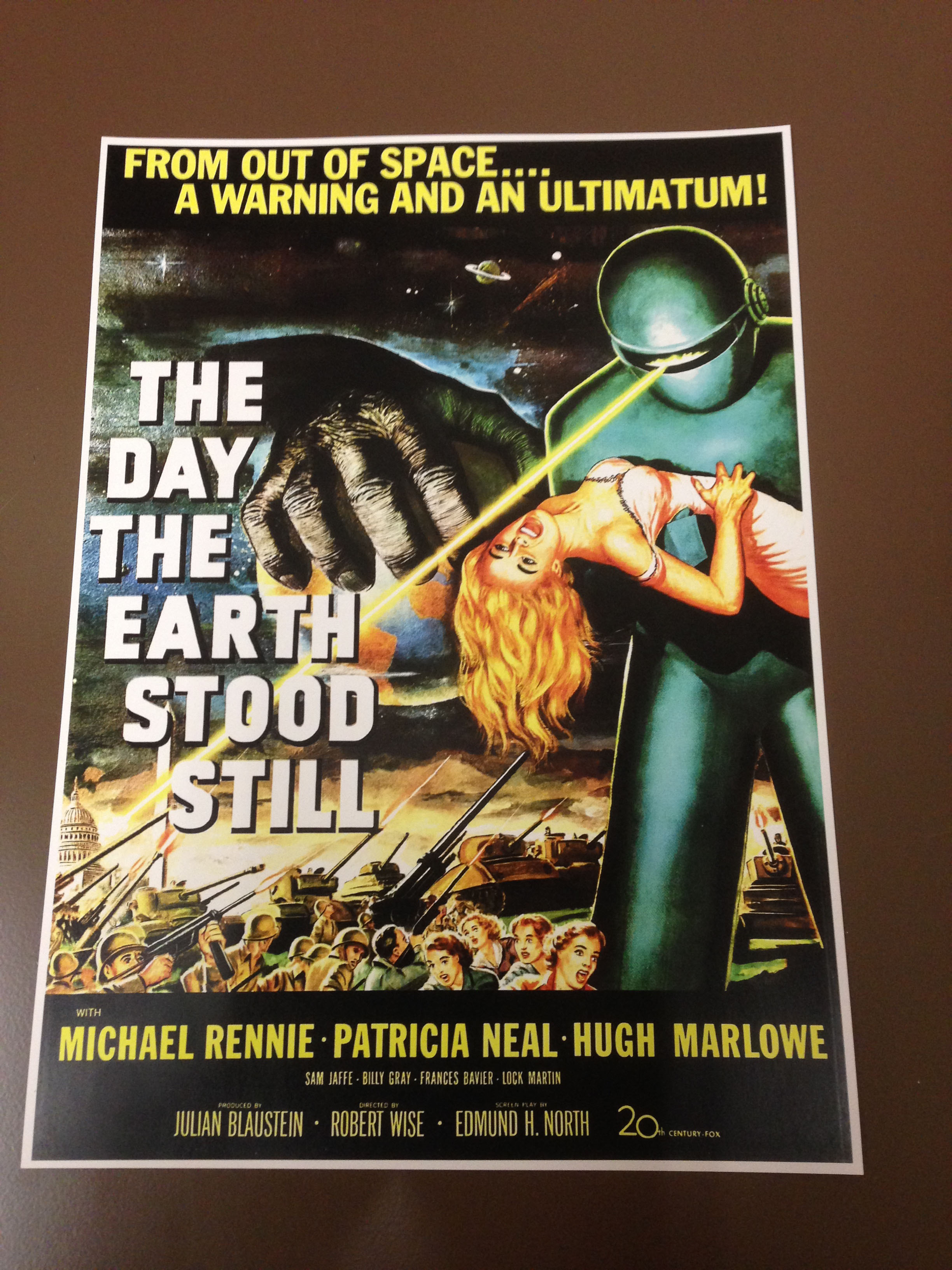

Here you go. Printed and hand cut on a cheap guillotine in maybe 5 minutes. I didn't do an A3 sheet just because set up would have been a nightmare. But, this can be done and time saving. And honestly, my hydraulic cutter would be more accurate than my hand cutting, and this is pretty spot on.

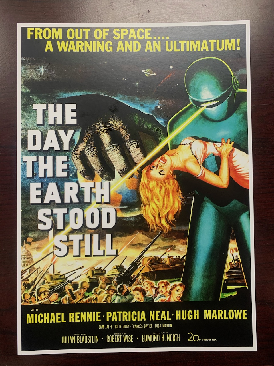

I printed the attached on SRA3 (for ease of setup) and quickly trimmed it with a 15 year old £50 Dahle rotary trimmer, it took about 5 minutes all in.
I'm not the most accurate at hand cutting and would normally use the Ideal 4850-95EP which would be perfect to within .1 of an mm.
I really think you'll save time and money by printing on a larger sheet and cutting down to the exact margins that you are wanting. A nice rotary trimmer would work well and you could hit your crop marks every time and have an exact margin. Spend a couple hundred bucks on this and see if it solves your problems. Ive spent way more to not solve any headaches before lol.

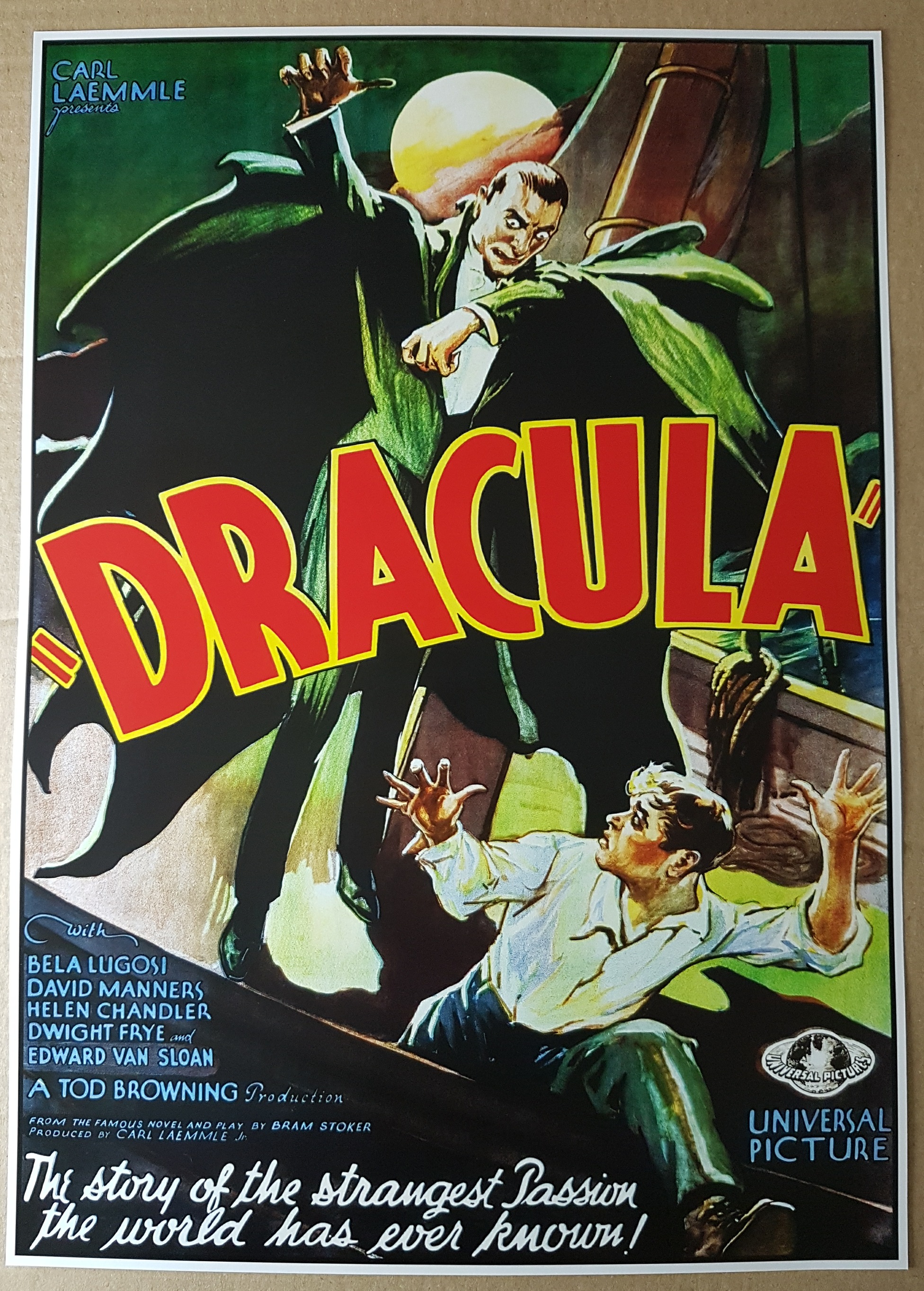

@Ynot_UK margin looks great & I appreciate your help.
The attached was printed scale to fit on the 550 though in 4 attempts on A4...so considering I've spent a LOT of money I would have expected I could get a 3mm border like the 550 could on the v180.

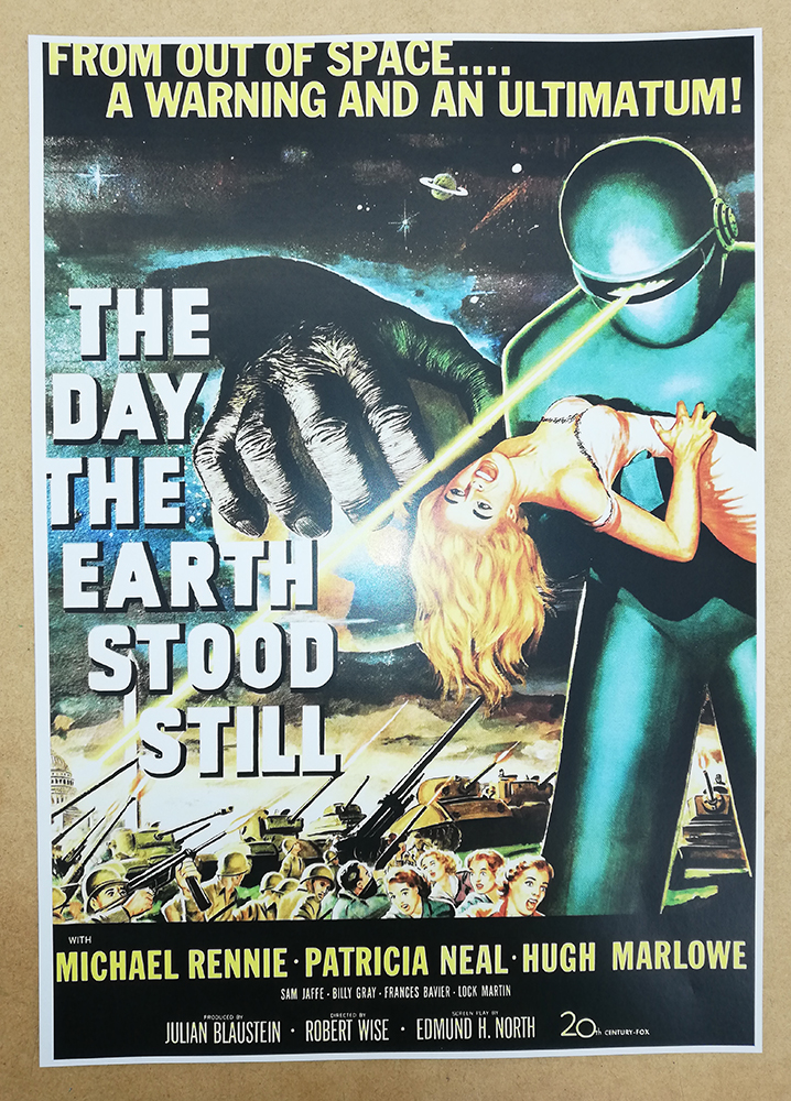

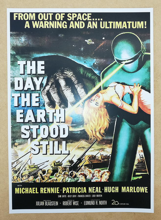

So, back in the office so had to test this and feck it to all my real orders. Versant80 here.
Don't have Mondi so used 200gsm ProDesign SRA3, as far as I know near identical.
Cut to A4 myself and placed in tray 2 LEF. Set to uncoated 177gsm-220gsm. Ran SIQA to set alignment before starting.
Printed at 100% from pdf to see what margins my machine cannot print from standard. 2mm top and bottom, left 4mm & right 2.5mm. (Note I know Tray 5 has bigger margins it cannot print) According to this a tech may be able to adjust these standard margins.
Next I reduced the print to 96% in the rip. This gives me a margin of exactly 4mm on both sides, with 6mm top and bottom, perfectly straight (obviously 6mm v 4mm because 96% of 297 is more than 96% of 210mm, so to achieve even all round would require layout in indesign etc or possibly acrobat script.
Now I've ran another 5 sheets and all are bang on and I mean bang on, no movement, and I'm a picky f$%ker when it comes to precision.
So basically I had two sheets waste, one for alignment and another to test 100%. And my first actual print was bang on what it should be.
Realistically I feel this is zero help to you but it just proves the machine should be able to do exactly what you're asking, even better than your 550 did as I managed in it on first sheet, all be it limited to 4mm margin!
